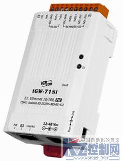

1 口隔离型RS-232/422/485及PoE供电的Modbus/TCP转RTU/ASCII精简型网关
